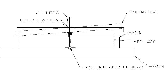

You are correct I get past this issue by shimming the upper bout so that from just past the upper waist through upper bout are not radiused on the tops. Also on the back I gradually pivot the axis of the sanding bowl to achieve a radiused taper starting at 2" low of the waist center through the upper bout to achieve the final upper bout tapper heitht on the back to side joint.
P.S. I am hand snding using a sanding bowl that is suspended on a all-thred rod screwed into a barrel nut seated in a slot cut in my bench. This allows me to pivot the the sanding bowl as required while maintaining constant perpendicularity to the sides.
clear as mud?

Clear as mud! I understand what you mean. I was thinking of making my upper bout flat too on my next. So does that mean put a piece of wood under the upper bout as I radius the top side in the radius dish?
PostPosted: Fri Sep 09, 2005 5:49 am
i believe you are speaking of the upper transvers brace and the upper trans vers graft. I put no radius on these braces. I radius the x-braces tone bars and finger braces but not the upper transvers braces.
second explanation:
I have a 1/2" barrel nut that swivels on one axis mounted in the work benck. Screwed into that barrel nut is a 12" long 1/2" all-thread. I have a 33/64" hole in the center of my sanding bowles. I put a two nuts, 1/2"id x 1"od washer, sanding bowl, washer and nut. This is the sanding machine. I put the rim in the mold and assemble the sanding machine. adjust the height of the saning bowl amd center location along the centerline on the rim assembly so that I sand the portion of the rim desired equally perpendicular to the centerline of the rim assembly. On the back I move the center locaion of the sanding bowl to 2" rear of the waist and no titlt and sand till the tail block is fully radiused. then a bit at a time I tilt the sanding bowl towoard the upper bout sanding as I go till I get to the required height and the bottom of the neck block is fully radiused at the neck/upper bout joint this gives a good clean radiused transition from the lower bout height to the neck joint height. My rim is pre profiled for the back so there is really not a bunch of sanding to do. The top square profiled and the procedure is pretty much the same except I dont radius much past the waist toward the upper bout.
Now I am sure this is really muddy
PostPosted: Fri Sep 09, 2005 5:57 am
[QUOTE=tl507362] Clear as mud! I understand what you mean. I was thinking of making my upper bout flat too on my next. So does that mean put a piece of wood under the upper bout as I radius the top side in the radius dish?
Tracy[/QUOTE]
I know I said i shim and I use to but now days I just tilt the bowl a bit towoard the lower bout (not much maybe 1/2 deg) and slowly work the tilt toward the upper bout, adjustin the sanding bowl height as I go till I get to where I want to stop the radius That way I don't have shim, but I do have to touch up the blend between radius and no radius by hand that takes a whole 2 min by hand. MichaelP38604.6267361111

Am I correct in thinking the radius dish can rock backwards and forwards ?
PostPosted: Fri Sep 09, 2005 7:12 am
Yes but the way my tie downs are set up I can lock it in any position as long as I dont yank real firm. I have pins that locate an lock the mold in position on the benck Dawgs as it were.

I think I know what you are talking about. In that picture, which side is the lower bout? Right or Left? Also, we are talking the TOP of the sides where the top will go right? I understand the back angle and radius okay, but it was the top that was throwing me. Am I correct in thinking that if if you radius your top in the upper bout, then the fb extension will hit the top just in front of the sound hole leaving a gap at the body/neck joint? If you set the neck angle to get rid of this gap, then won't the neck angle be too extreme, meaning that the bridge would have to be too tall to play comfortably?

The sketch is more of a reprasentation of doing the back. on the top the tilt almost neglisable like I said a 1/2 deg at the most. If you tilted more than that the bridge would set atifically low.

So once the dish angle is set you can hold the plane as long as the dish is not rocked too much ?
Russell
PostPosted: Fri Sep 09, 2005 8:11 am
yep. I made my barrel nut 1" in dia my tie downs have less than full radius so the tighter I tighten the tie downs the firmer it holds. They are held down with 4 1/4-20unc bolts. The barrel nut by the way is brass and knerled where the tie downs cross it
